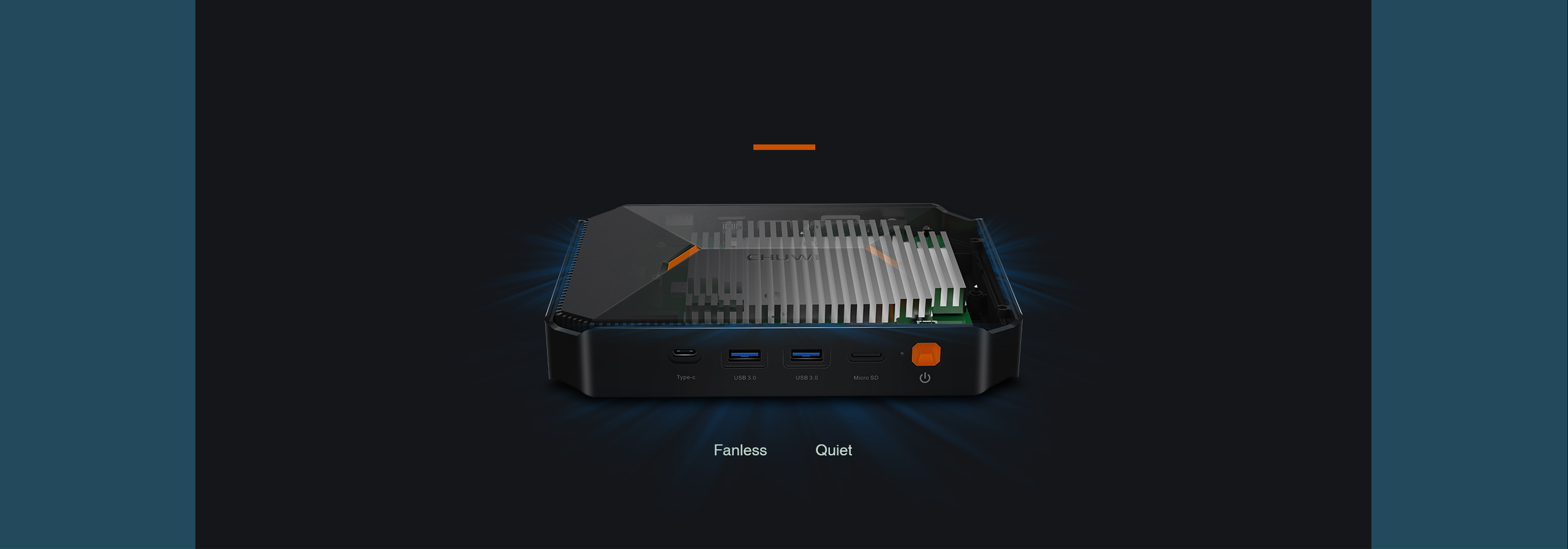

On the official ChuWi Hero Box page Product page
They show a pretty image of the HB with the top ghosted so you can see the elaborate finned CPU cooler inside
ChuWi phony CPU cooler
With claims of “Scientific Design-Effective Heat Dissipation” and “Continuous 4-hour in use, it stays 34℃”
BS! Their Scientific Design is a flat aluminum plate 3mm thick over the CPU. No fins, no science, no proper airflow just a small chunk of AL. No wonder it can’t take extended running - ChuWi’s idea of “Continuous 4-hr use” must mean turning it on and only letting it idle.

So there is no big finned aluminum cooler?? Jeez! Can’t understand why they do things like this. It’s not like that finned alu cooler costs 50$.
Can you remove their flat alu cooler and replace it with a better copper or finned alu?
“Can you remove their flat alu cooler and replace it with a better copper or finned alu?”
Existing plate does have mounting screws to MB, but gamble which will be stronger, mount of CPU to it’s socket, or whatever glue/thermal compound was used. Pull or twist on AL plate and you may bork the CPU pins/BGA and have a cool brick. Probably better to leave the plate in place and attach an big finned cooler to it with some good thermal compound. I have big selection of passive cooling on old video cards, but still would have to deal with the problem of getting air in & out of case. Lots of existing holes, but all small & in wrong place - would need to cut the top open for clearance and to let hot air out…
For now, I can still use it for another HTPC by throttling the Win10 CPU power profile to 85% which limits max CPU speed to 1 GHz. Still fast enough to play HD video over network and keep temps under 70C after 90 mins playback. Too bad - already had 2 other brand mini HTPCs that can do that. Really bought this to put a 1TB SSD in and use for my file server also.
