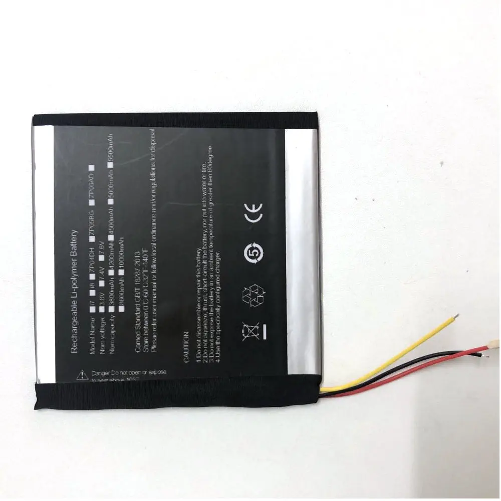

The battery in my tablet discharges when turned off and sitting overnight. Can the battery be replaced easily?
Se cambia facilmente, el problema es encontrar donde comprarla
  1. If the tablet is suspended, by pressing the power button, the tablet will not be turned off and will continue to consume power since all devices are still connected except the screen. In normal use, the battery should last at least 6 hours.
  2. If you actually turn off the tablet completely and the next day the battery is drained, you will need to change the battery.
To get it you must first open the tablet and see the battery model, dimensions and thickness to get another equal or compatible in Alí Express
