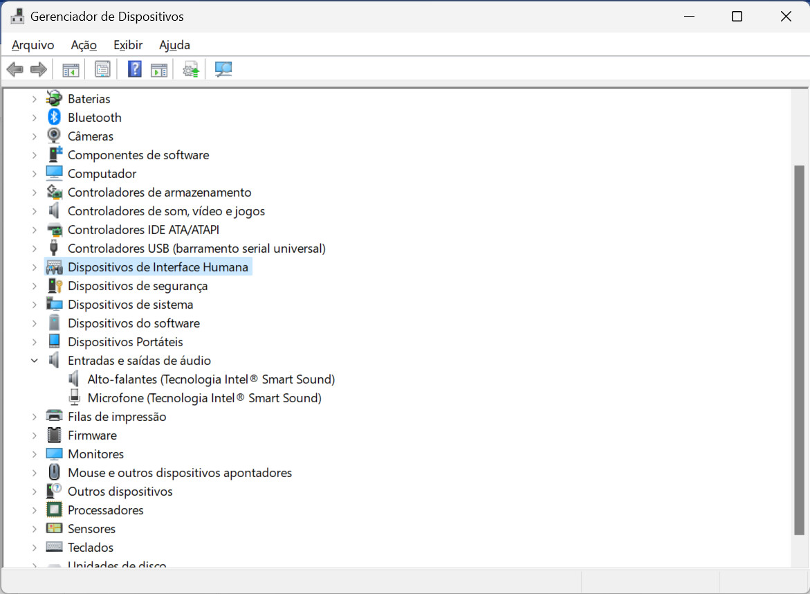

Hi harlleysathler,
I was able to reinstall some drivers (mixing some older ones found on the net, some from different sources for other chuwi products) and recovered some sound options like before, but still no sound and a strange behavior from one driver… could you please do only two more screenshots from your device manager please to be sure to have all the same, that woud be so great!
I would need:
  • Inputs Output Audio
  • Audio Process Object (APO) if you have such an entry in your system.
A big thanks in advance for your precious help!
Hi, @Pirhana-A,
I can’t find anything related to Audio Process Obeject though…
