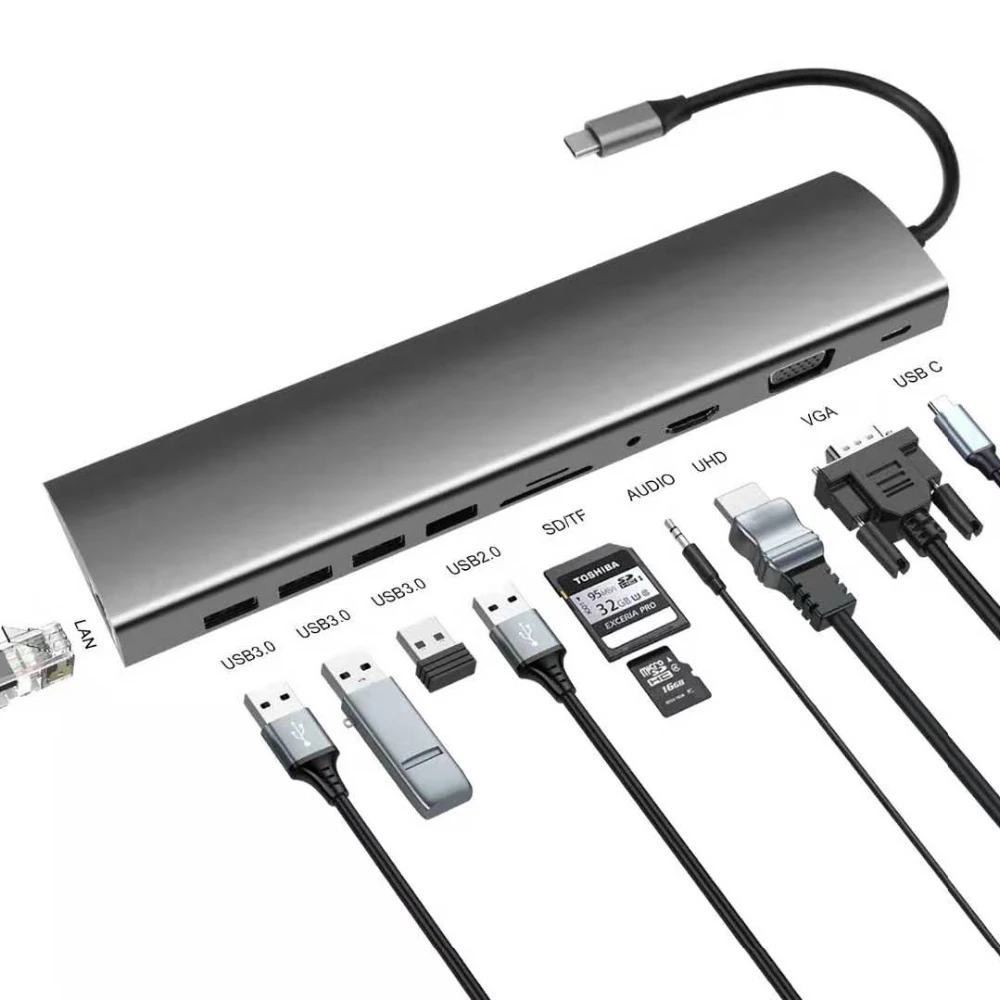

Esto fue lo que compré:
both cannot charge the laptop, although at the desctriptions says, that they can, the didnt do it properly.
the first model 1 second charges and the next one stopped and started again. the second model disconnect from the laptop, when you connect the charger.
