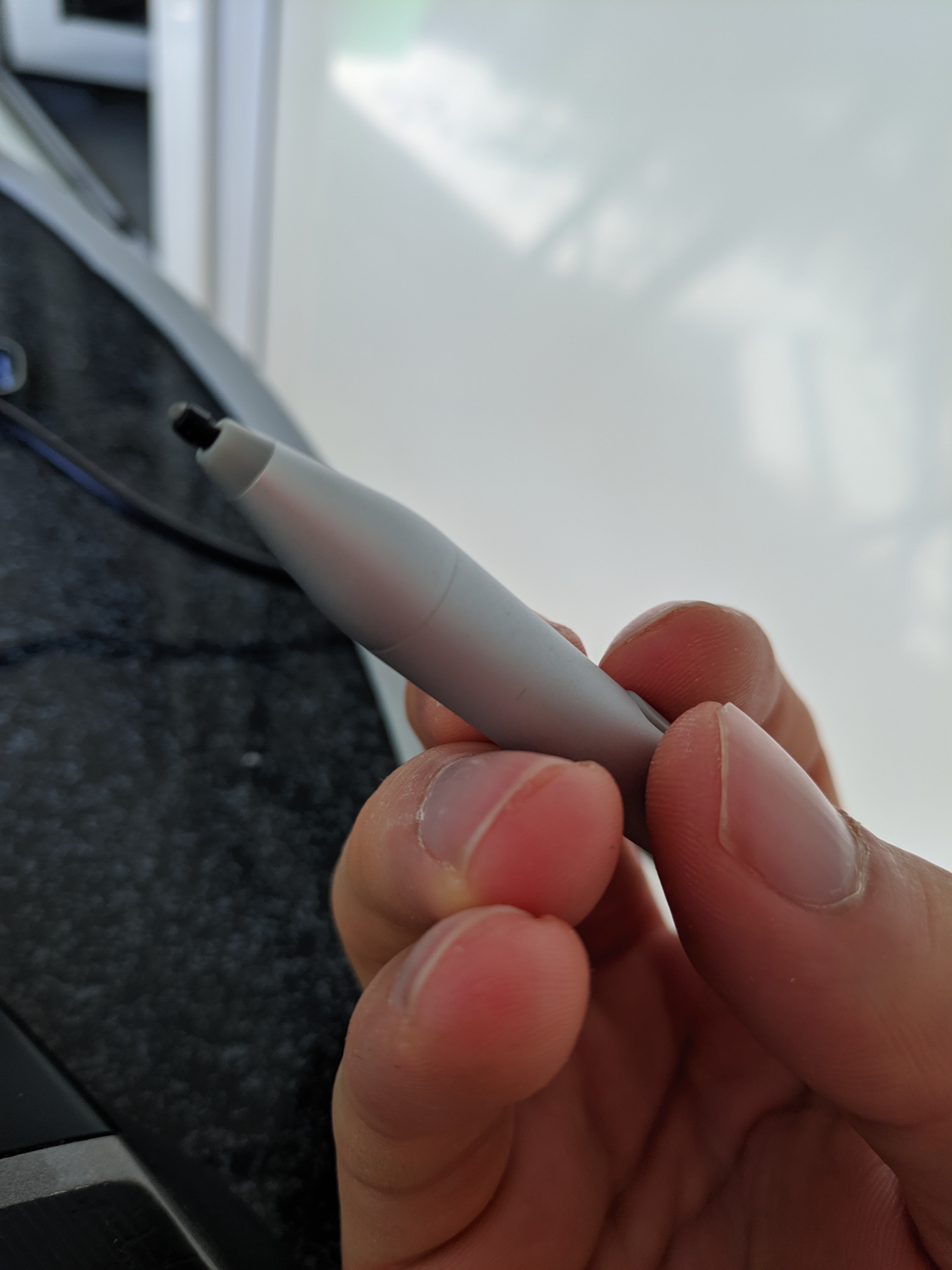

are they any official Tip to buy from chuwi, and has it some different strengh h, hb or b ?
And can i buy those from Microsoft tip hb and replace it with the one at the h6 pen ?

For all who want to know you can actually use the MS Tips
So If u want to have an softer Tip just buy those and replace it.

Little update:
In the beginning the MS Tips went pretty good, unfortunately the writing breaks now much more often, I think because the diameter of the tips is a little bit smaller, but with the change to the tips from Chuwi, it has improved again. I don’t think my H6 pen ever worked properly, because it always breaks while writing. There are gaps between my applied stroke and until I stop writing.
Does anyone have any advice on this, or should I order a new pen?

So for all, the update 2004erase the one made from Chuwi, i have the same expience like you, see in picture:
Also i have a strange interaction, now the MS Tip works fine but the Tip from Chuwi has massiv problems.
MS Tip HB:
CHUWI Tip:
i am not sure whats the meaning of this is, sould i reinstall the Driver from Chuwi Official ? Maybe the Management has an answer to this.
