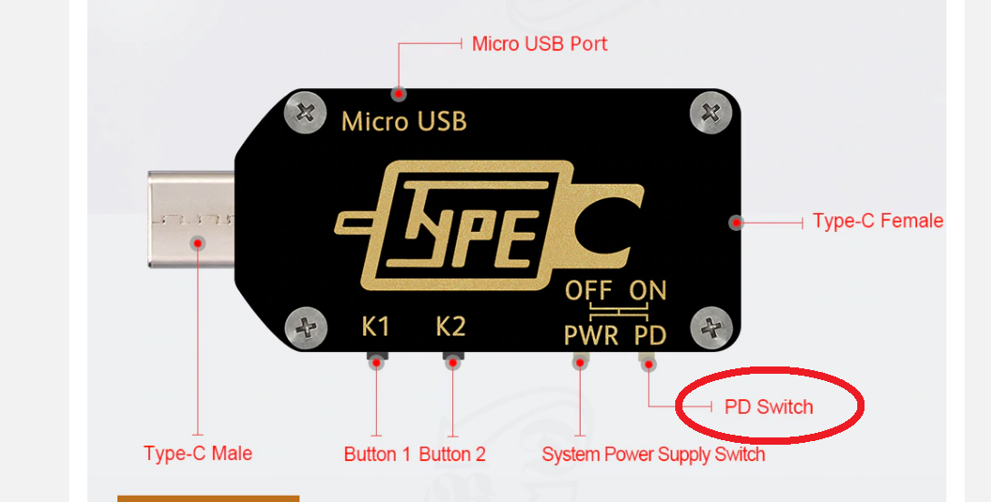

If you want to use third party charger you need to connect it via PD trigger or search for another chargers that will be compatible.

Something like this
https://aliexpress.ru/item/32968303350.html?spm=a2g0n.seo-amp-search.searchResult.32968303350
You need to enable PD by force.

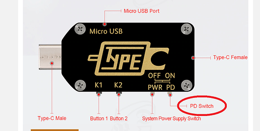

Hi.
Can someone explain how this device would work? It says it is a tester. Do you just plug in and it just works or do you have to configure it to do the PD trigger (if yes, how)? Thanks.
-Bill
You need to change voltage by pressing button on the side of it.

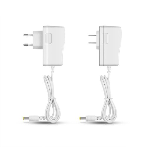

I used it. It works.
DC 12V2A
DC to Type-C
All of that seems way over complicated.
Here’s how I solved the problem when my charger was lost for my Chuwi hi10X:
Amazon order-
12v 2a charger
Brand: Trnaroy
4.4 out of 5 stars 839Reviews
Brand: Trnaroy
Universal AC/DC Adapter 12V 2Amp Power Supply with 8 Switching Connector Adapter Tips and USB Plug for Household Electronics Routers Speakers CCTV Cameras… $18
Then I went to Walmart and bought a mini USB-to-type C adapter by Onn, for $3.
I used the charger with the usb tip, and then put the adapter on the tip, and it worked to charge my Chuxi Hi10X.
Oh, and there is no settings to tinker with. It is just plug-and-go!
