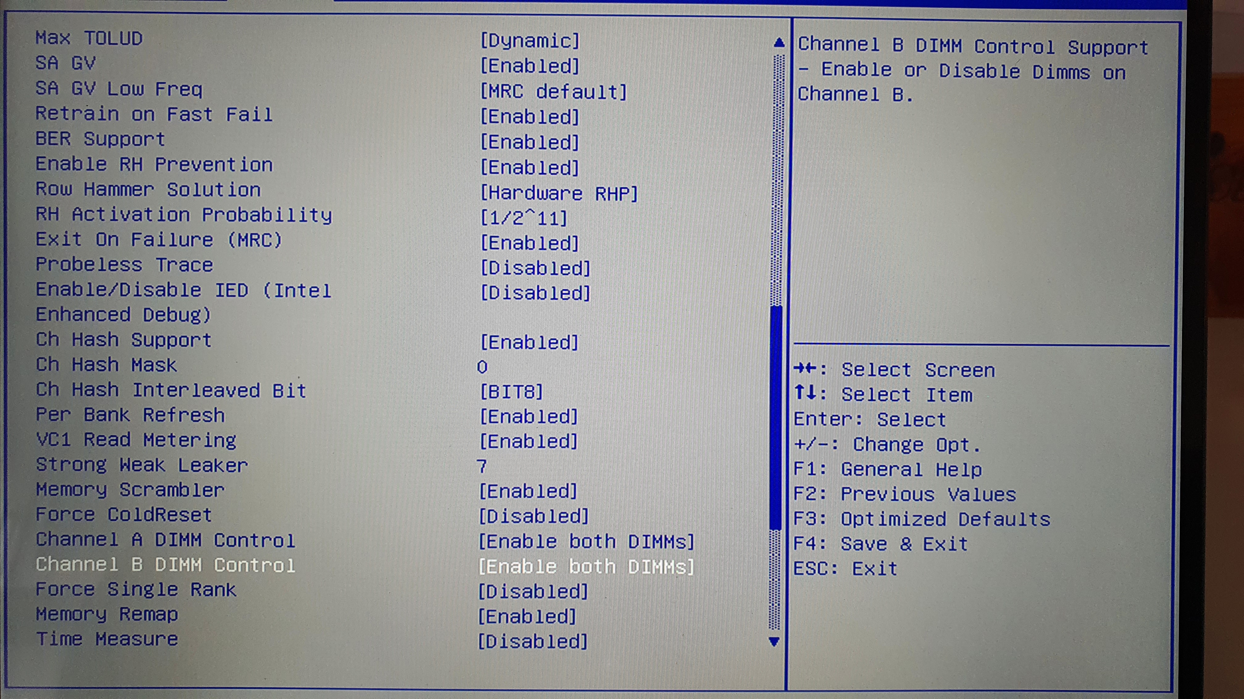

Hola, te detectó a la primera la memoria?? Hiciste algún cambio en BIOS??, he intentado con 5 marcas distintas y ninguna me lo detecta windows
@Lord_Trebla There is the BIOS option (on the i5-8259U version): ChipsetSystem Agent (SA) ConfigurationMemory ConfigurationChannel B DIMM Control. It should be set to Enable Both DIMMs but that’s the default. If you changed it, you’d probably remember.

is enabled and still doesn't detect the new RAM.
As far as I remember I only changed the function keys in BIOS

thanks @fat_bird for the help but I have it activated and it does not recognize the RAM.
I have attached a photo, in case you see any option that is not correct, but I do not remember having modified the BIOS
I compared your settings with mine. They’re exactly the same. It’s all as it should be there. I don’t think it’s down to any BIOS setting.
When you install the memory, does the laptop take longer to POST (black screen before it shows the logo)? That would suggest some incompatibility. But in this case it’s more likely it wouldn’t boot at all. And you say you tried 5 different modules. It’s unlikely all of them would be incompatible.
