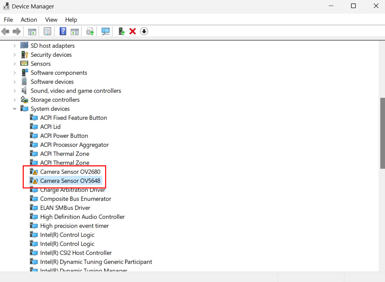

it show this after update the driver
and still show
and when click on it and show detail
Tech told me that in this case camera is either not well connected to the motherboard or is broken. Is there anything you did before it happened? When did you buy?
