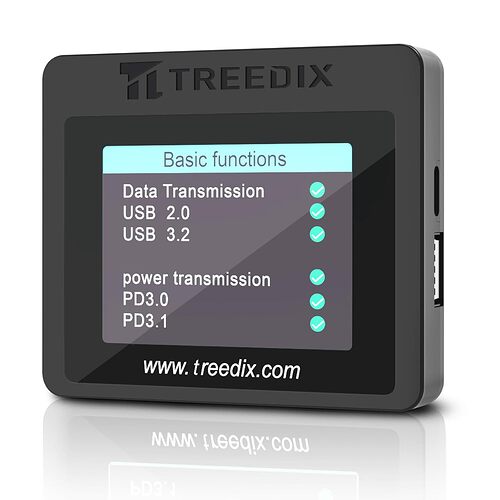

And a universal USB cable conductivity tester from Treedix.
