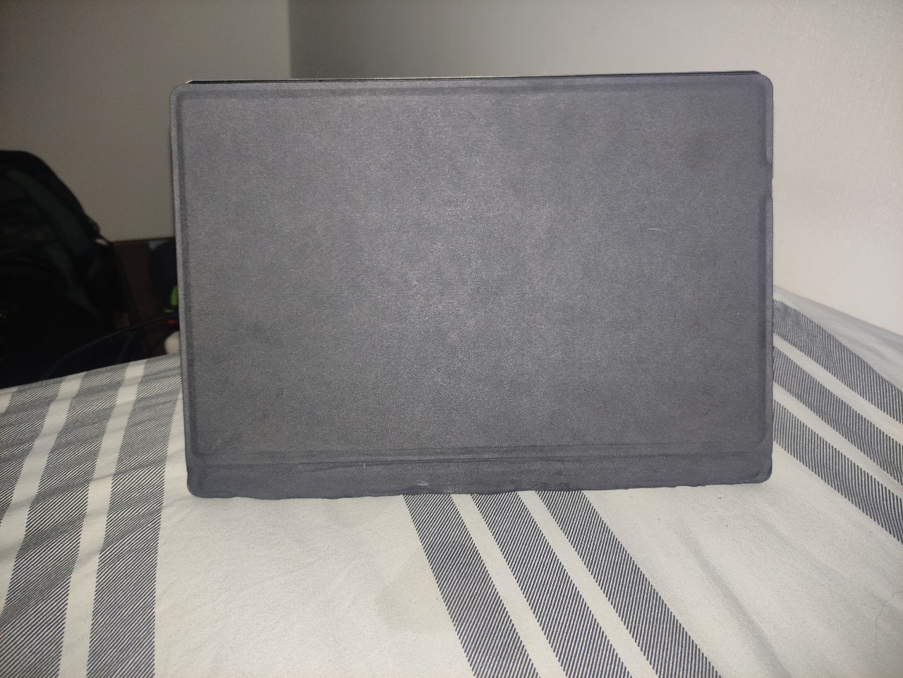

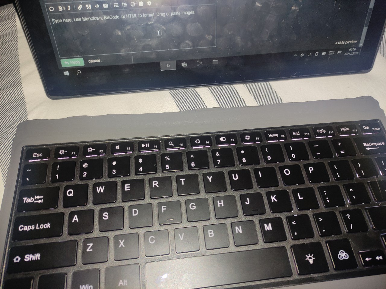

the keyboard has arrived. But there are several problems with it. Not only the connector from this keyboard does not fit the ubook, but also the magnetic stripe (different arrangement of magnets). So, I had to change it to the one that was in the original keyboard. Due to the fact that the magnetic stripe from the ubook is thicker than that of the surface, it took up more space, because of this it was not possible to install the connector so that the laptop closes as it should. As a result, I decided to leave the magnetic stripe, and refuse the connector (it still does not charge this keyboard). I say in advance that the connector on the surface is smaller than that of the ubook, so replacing it is very difficult, because it sticks out from the fabric. In general, the keyboard itself for the surface is much better and although it holds on a laptop so-so I’m happy with the result.
