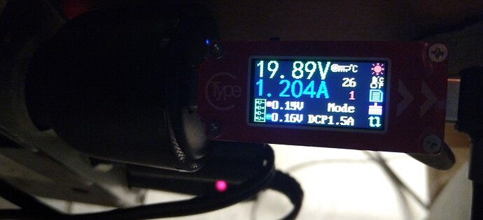

I bought a new car charger…
…and with this one it worked like a charm (I own the GemiBook with USB Type C enabled in BIOS (2.20.1273 (2021))).
Now it charges like this (at 12 V car battery):
DCP1.5A
