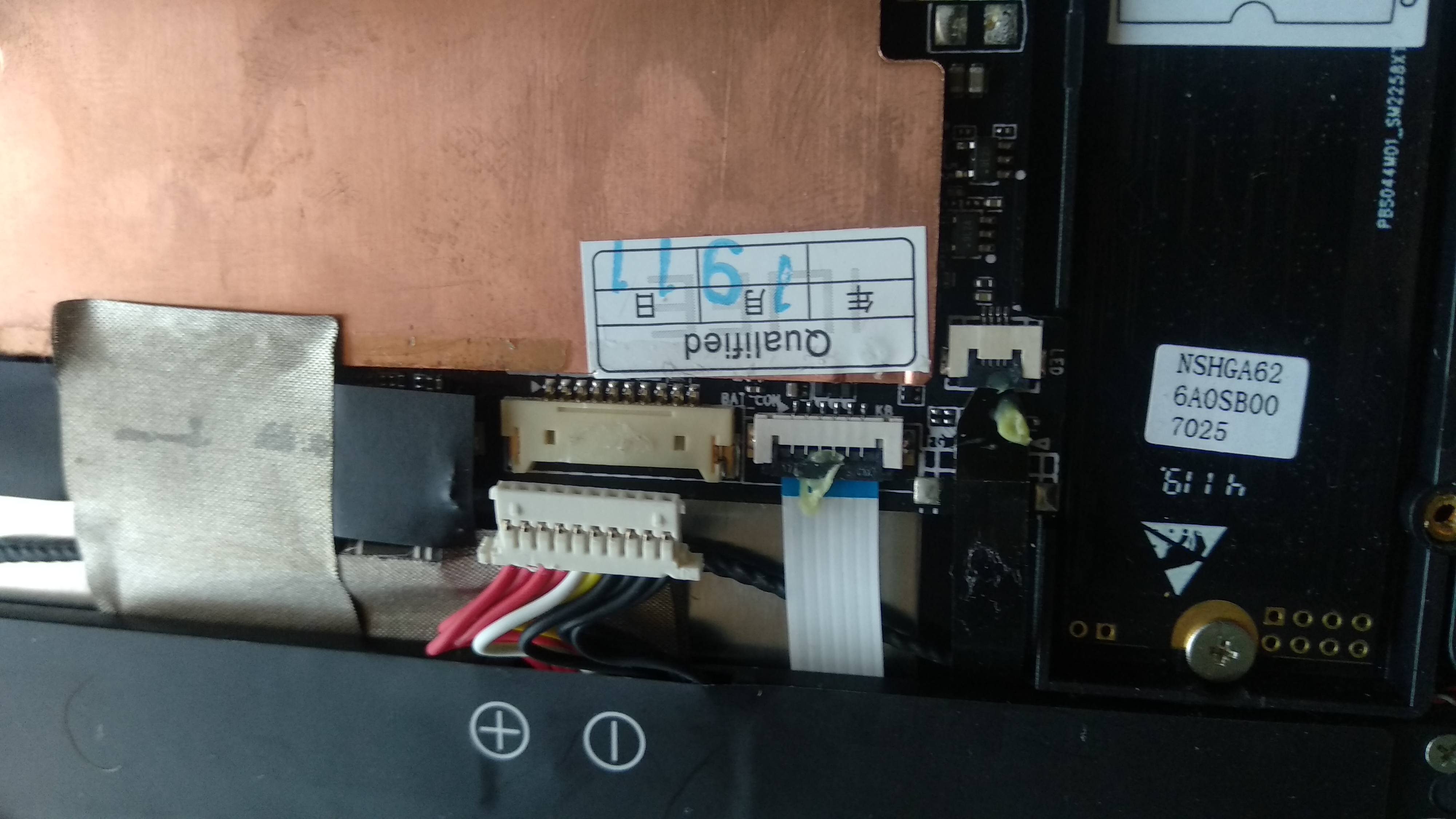

I had the same problem, i tried to fix it reflashing the BIOS but something went wrong and it kinda bricked itself (black screen and nothing happening at startup). So I tried to disconnect the battery for several hours to reset the BIOS. This procedure fixed the bios AND the waking from sleep mode problem!
So for those who can’t wake the laptop up, well try this. To locate the battery connector see the picture here
Hope it helps
