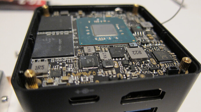

actually you cant use 60x60mm fan, as you cant remove top part of box, bcz its part of mount system, what keep whole box together. So only what you can do (and what i plan to do), is cut hole thru top part (basicaly in dimension of fan+exhaust), remove it, and then replace it with some bigger piece of pasive cooler in shape of Y, where base is more less 40x50mm, about 1cm high, where top can be another 1cm 60x60mm with place for big fan. ofc this require drill holes in new passiv and srew it to original copper plate, as you cant actually mount new pasive part directly to cpu, you must use original heatsing as “reduction” to new one

I guess you didn’t look at my cooling solution where I used some barrel hardware to hold mine together.
@Donut it doesn’t look like that heatsink is making adequate contact with the CPU?
yep i saw it (and then forget about it :D) i am actually thinking about to modified top cover instead your solution, it looks like it make whole box too much bigger, i can understand, what you did, but just, how do you measure heigh of that copper pieces? did you just made it by eye or do you measure it excatly to 0,001mm ? i am afraid, that you can damage the cpu with too much presure you will apply…
I guess you didn’t look at my cooling solution!
Yeah, I had to thermal adhesive some copper to transfer the heat to my heatsink/fan.

I tried Gelid GP-Extreme Thermalpad 120x20x1mm,
Temperature 45 after boot, goes to 55 then fan starts to bark)) lowers to 53 and off… so got same result as you.
The problem is that fan on and off every minute, omg, whyyyy i cant just turn it on constantly with 50% speed…
After that i changed gelid to copper plate .7mm and added Kryonaut thermal greese 12 wmk to both sides.
Now cpu temperature 38 after boot. And rest not changed. It slowly goes to 55, and fan turns on…
Now im searching for some bios thermal values, try different adjustments, but its kinda useless… fan always turns on ar 55 degrees😔
What else im gonna try… just buy reostatic usb fan on aliexpress, and place it on the top. So i can run it on low speed, and maybe chuwi fan will never turns on…
Also i can theoretically 3dprint new cover for larkbox, 20-40mm higher, and place there reostatic module with bigger fan. But honestly its weird… maybe i can just 3d print another minipc instead of lark…Chuwi, why you cant make a good product, and dont make ppl mad with larkbox experience(

Well… I’ve just received my copper plates yesterday, at about same time @Cervantez posted… anyway I tried myself swapping the Gelid pad with a 1.5x1.5x 0.8mm copper sheet and…

its kinda hiden link, but Donut already invented basicaly ONLY one possible solution, how keep larkbox quiet and more less passive cooled
https://imgur.com/a/E00VvsP
you cant use thermal paste, bcz cpu and heat sink literally does NOT touch each other, you must use provided (shitty) tape, you also cant use passive heatsink directly to cpu, bcz there are small electronics parts, which you will break, over all, cooling part of larkbox is extremely bad design, and there is basicaly nothing, how you can fix it yourself
That’s not correct.
You can use an intermediate thin copper sheet and thermal compound between CPU-sheet-heatsink without any issues, it improves thermals slightly, but the real problem of the larkbox is the activation point of the fan, because Celeron J4115 has a Tjunction temperature of 105ºC, so CHUWI hardcoded on BIOS (actually on firmware because BIOS settings are useless), the activation of that f* annoying little piece of garbage of fan at half the maximun running temperature of the processor. This CPU can happily run at 80ºC its whole life, so, Why not to put at 80ºC the ramping point? (Clue: Chuwi’s “engineers” have absolutely no idea how to, because the larkbox is made by a third party challenger).
