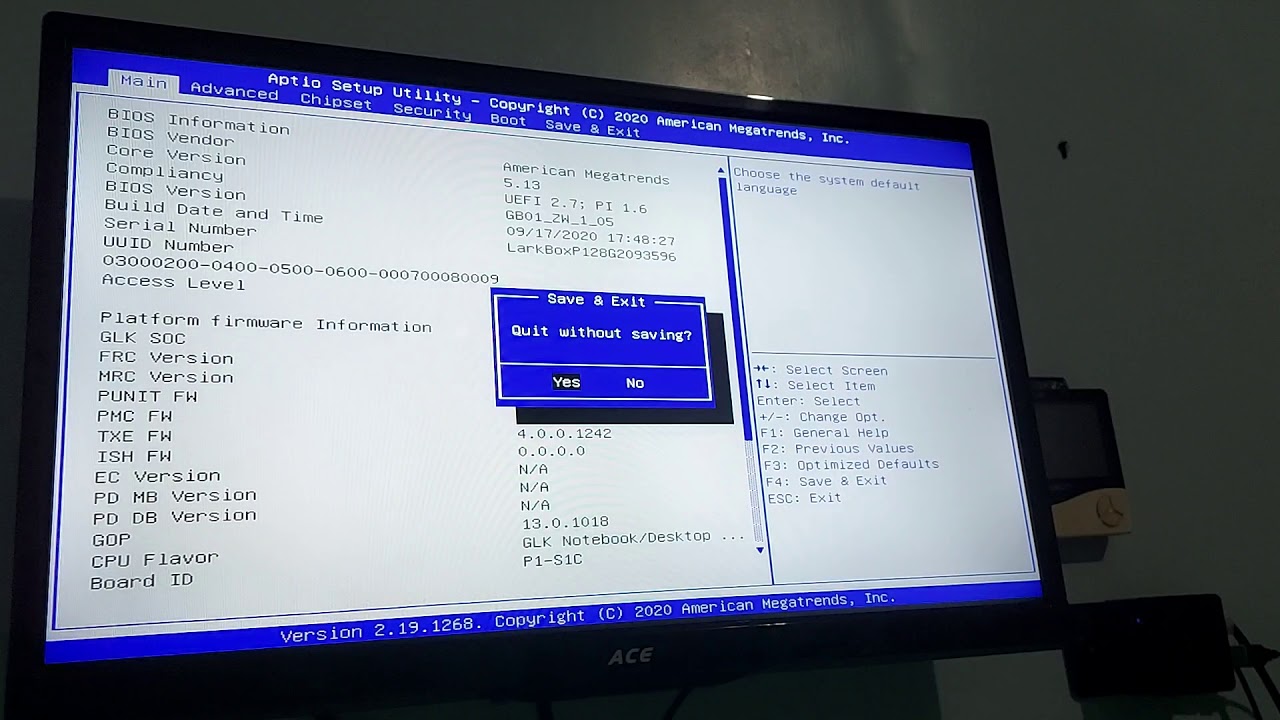

My larkbox pro has been acting weird. It just starts shutting off randomly and when I turn it back on will be stuck at bios. And no matter how i get out of bios, it will immediately turn me back to bios instantly. I would have to unplug the device just to boot it normally.

Would you mind attaching a screenshot of your thermal settings on your bios. I would like to try it.
I managed to tinker with mine. I temporarily disabled the thermal settings, and my device reached 80 to 90C with without shutting down… ofcourse i shut it down so not to further ruin the device.
So i just need a GOOD thermal setting. I would really appreciate it.

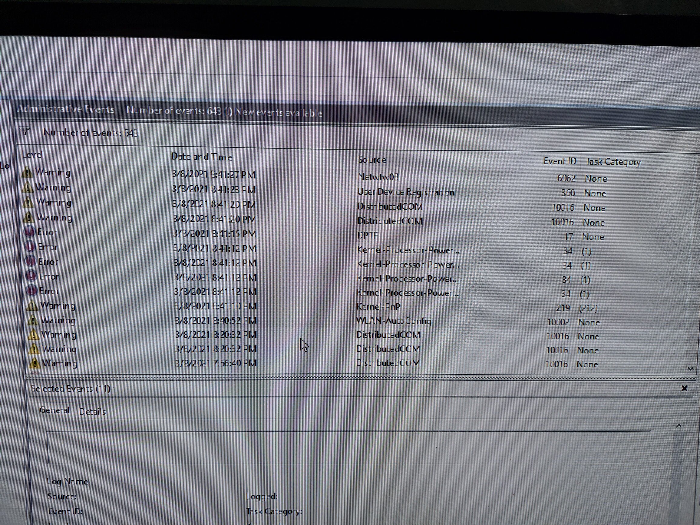

I have the same error 34. But with no event error 55…
I am new to this event viewer. I have no idea how to diagnose using event viewer.
