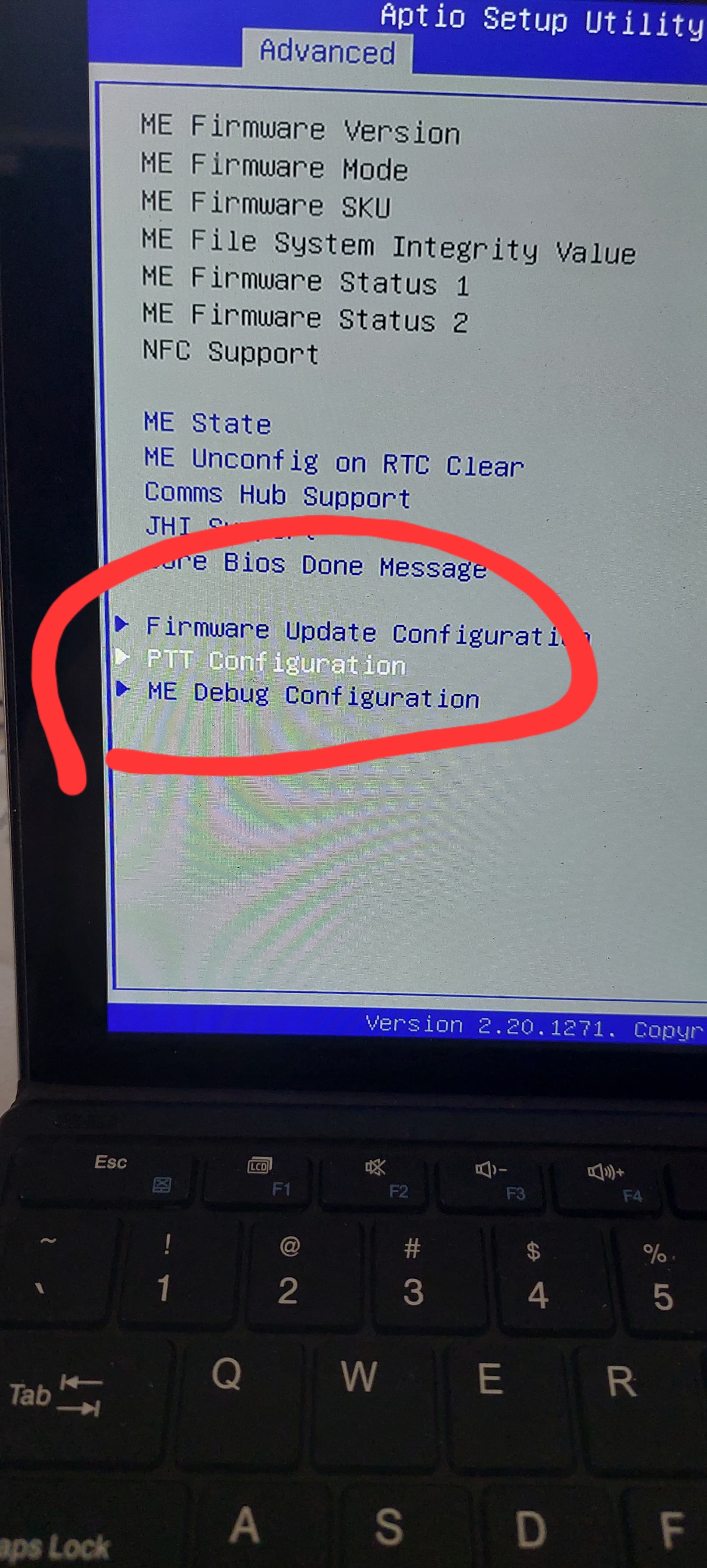

I am attempting to update Windows 11 on this tablet and it will not proceed because it does not detect the TPM. Device Manager does not show a security processor, even though the Core i5-10210Y supports it. Windows 11 came factory installed on this tablet, so it must be possible.
In UEFI, security module is set to enable, but none is detected.

I am not sure why you would immediately insinuate that it was something I did rather than it being a potential hardware failure. I did nothing to disable it in the UEFI BIOS. In fact, I even reset the BIOS back to default settings.
If you look at photos I attached to the original post, you would see that I already opened the BIOS and clearly already know how to do this. You don’t need to regurgitate the instructions from the Microsoft post that I have already read.

Unfortunately, the problem is not solved. The TPM is not detected by either the BIOS or the OS. The photos I attached show this clearly. What I am trying to ascertain is whether or not this is going to require a hardware replacement.
As stated before, I can see the TPM in the N4120 version of this tablet without any problem, so I have already been in the BIOS on a functional machine and I can see where it should be detected and visible.
If the BIOS is somehow corrupted, I have no way to re-flash it without Chuwi providing a binary. Again, resetting BIOS defaults did not resolve the issue.

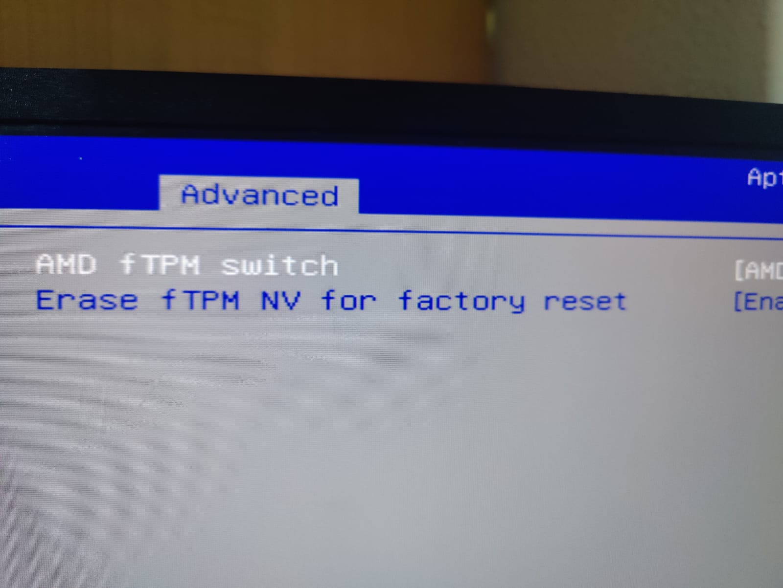

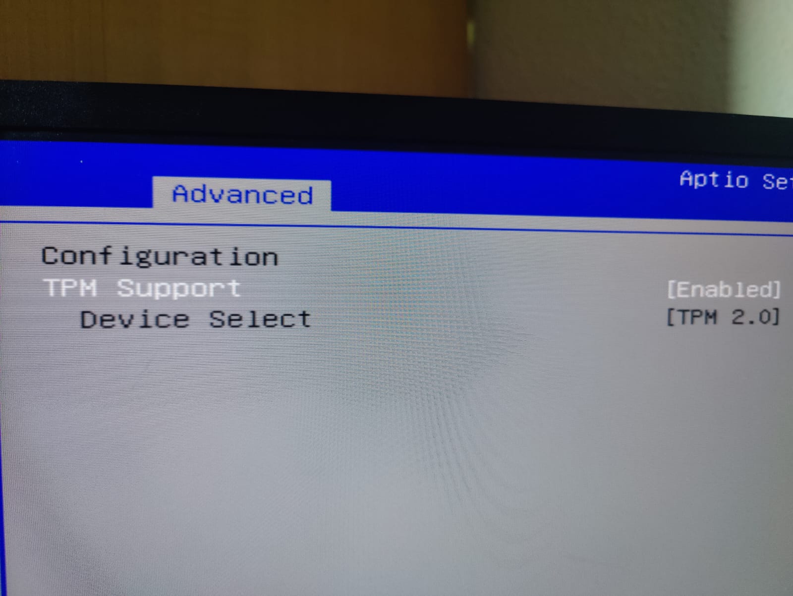

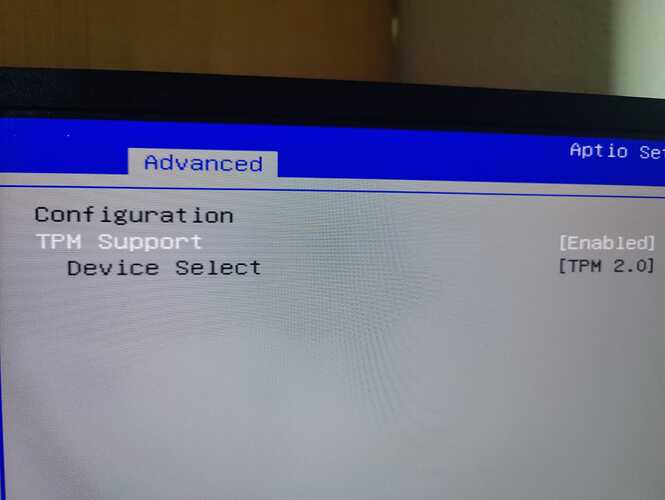

You can check these two TPM settings.

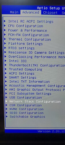

Can you upload a photo of the second configuration ?
This BIOS does not have that option (at least not that I can see), only the one I posted previously (the “TrustedComputing” option shown here).

I don’t have the same computer.
I’ll show you both settings.
There is no AMD TPM on this Intel machine.

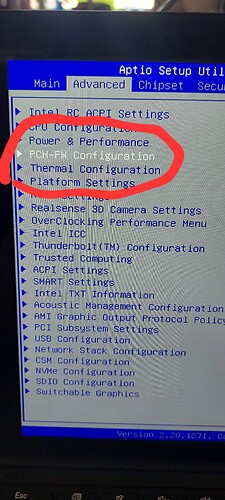

I seem to have solved it. The TPM mode somehow got changed.
The two things I changed were TPM Device Selection (to PTT), as well as firmware mode to “Production”.
After saving those changes and doing a full hard reset, the BIOS and OS both now see the TPM.
The question is: how did this get messed up in the first place? We’ll probably never know.
