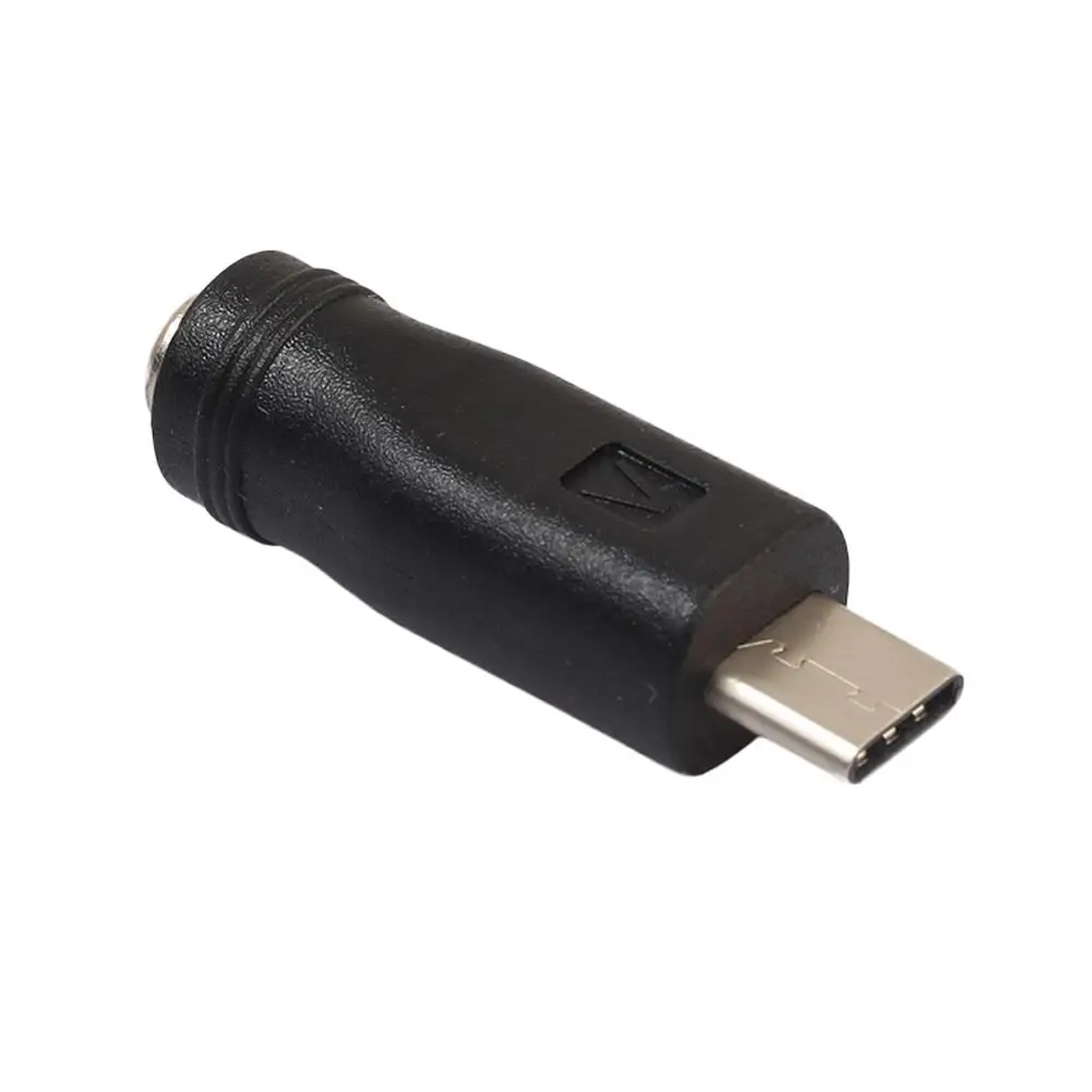

a charger that claims to provide various voltages will not work, this is typical of PD and Fast charge technology, they typically receive info from the connected device as to what their charging voltage requirement is, but the Hi10X does not provide this sensing technology.
If you cant find a 12v 2amp (or greater amp) usb-c charger in your country then you could purchase a typical 12v 2amp (or greater amp) charger that will most likely have a DC tip on it with an outside diameter of 5.5mm and an internal diameter of 2.5mm, then purchase a DC tip to usb-c adapter.

I located a cable on Amazon, chopped off the barrel connector and connected it directly to a 12v supply, and can confirm that it charges the Hi10x perfectly. Again, the link to the cable in Amazon

What about this combination? If it works, the cost is under $5 including shipping!
