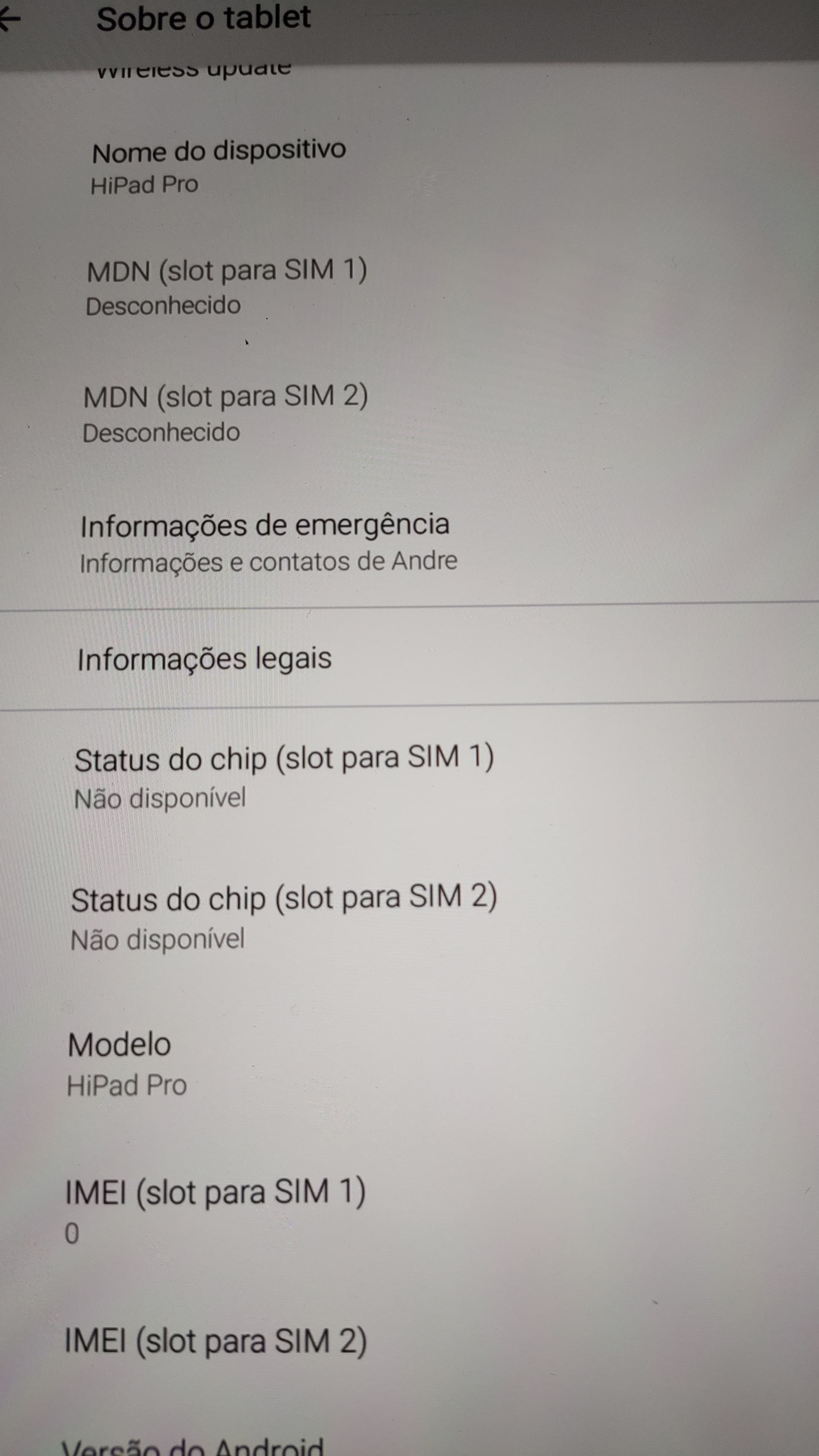

Hi Anathema unfortunately Bootloader is locked and update is different from OTA update and by errors in tutorial I lost my drm keys for widevine L1 and also imei (it shows 0 in both imeis) info, but that could be avoided just doing a backup of some files before flash in case they were erased in that tutorial. I will try to correct the pdf and explain also how to install the right drivers because that tutorial is a disaster. I really don“t give importance to Widevine L1 and Imei“s Because I don“t use Netflix and neither Sim Card.

I too have lost the IMEI numbers by selecting ā€œerase all dataā€ as told on the tutorial. Later i’ll look into a way to clone from an old phone. The information on this topic could be useful for unbrincking the Hipad Pro and should not be removed. It was a real pain to restore the system after the flashing. The bootloader still locked and can’t be unlocked via fastboot, for now I see no reason for flashing this firmware.

By the way, try flash this to restore IMEI. This is backup of IMEI for Qualcomm devices.
