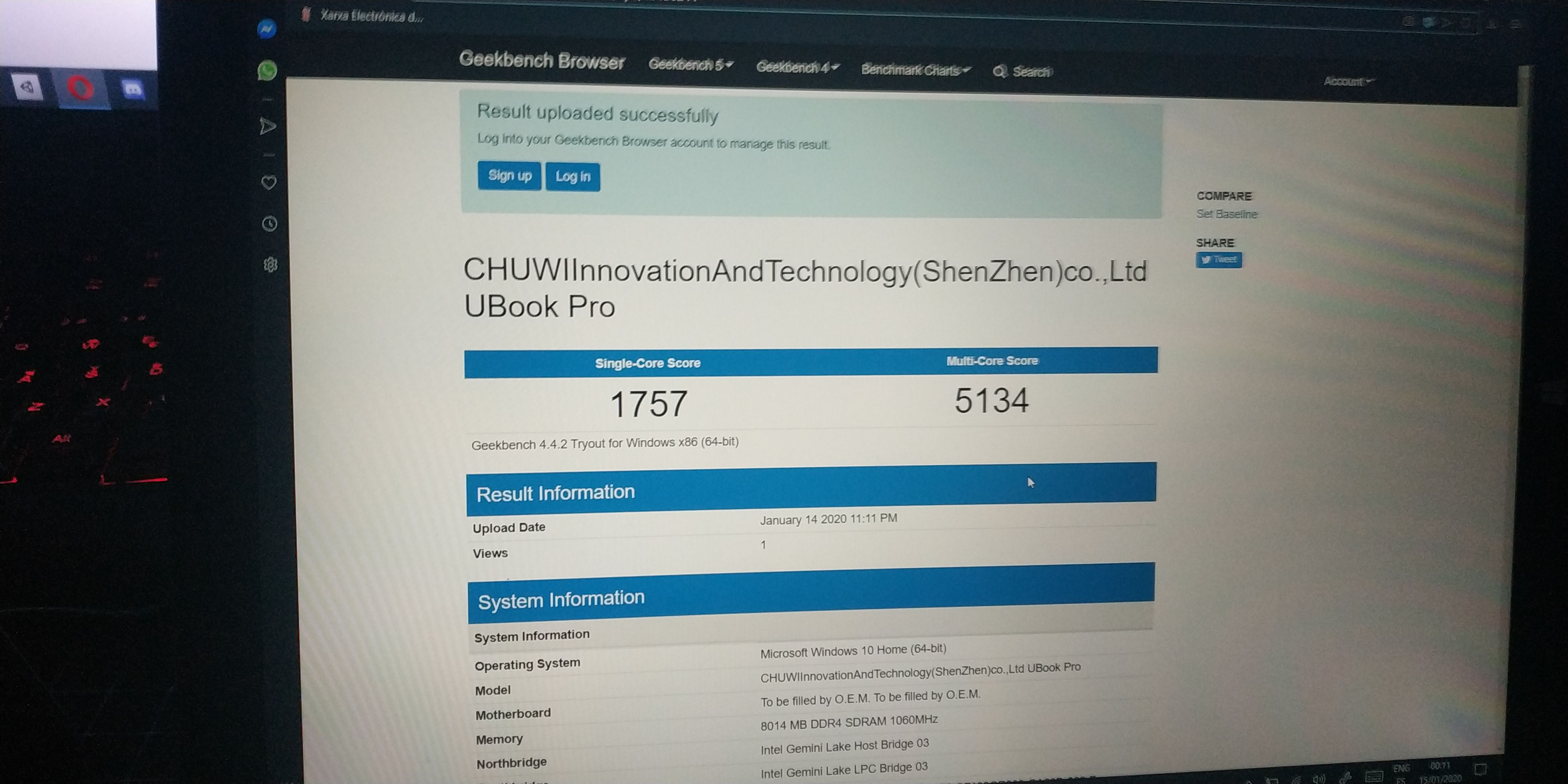

Got mine a week ago and this is what I’m getting. You may have your cpu limited either from the bios or from windows. Mine is surprisingly fast, for what it is. i can even run Android emulators in it, and i get 50fps average fps in HL2 lost coast benchmark at 720p max quality except texture filtering. I liked it so much i got a second one…

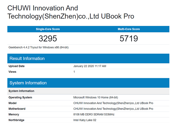

You used Geekbench 4 not Geekbench 5 so you will get different results. My Geekbench 4 results are as below.
I realized that a bit late. I’mma pass geekbench 5 when i get home from work.
Btw, your uBook pro has the m3 cpu, right? Or did you somehow OC’d it? I have the n4100 cpu with power consumption unlocked, and it draws about 15w compared to the 6w it did when i got it… There’s is no way you got over 3000 on single core with the n4100
Edit: yeah, it says kaby lake, and on mine says Gemini lake, so not same cpu. Still, nice to see multi-core on the n4100 is almost on par with the m3
