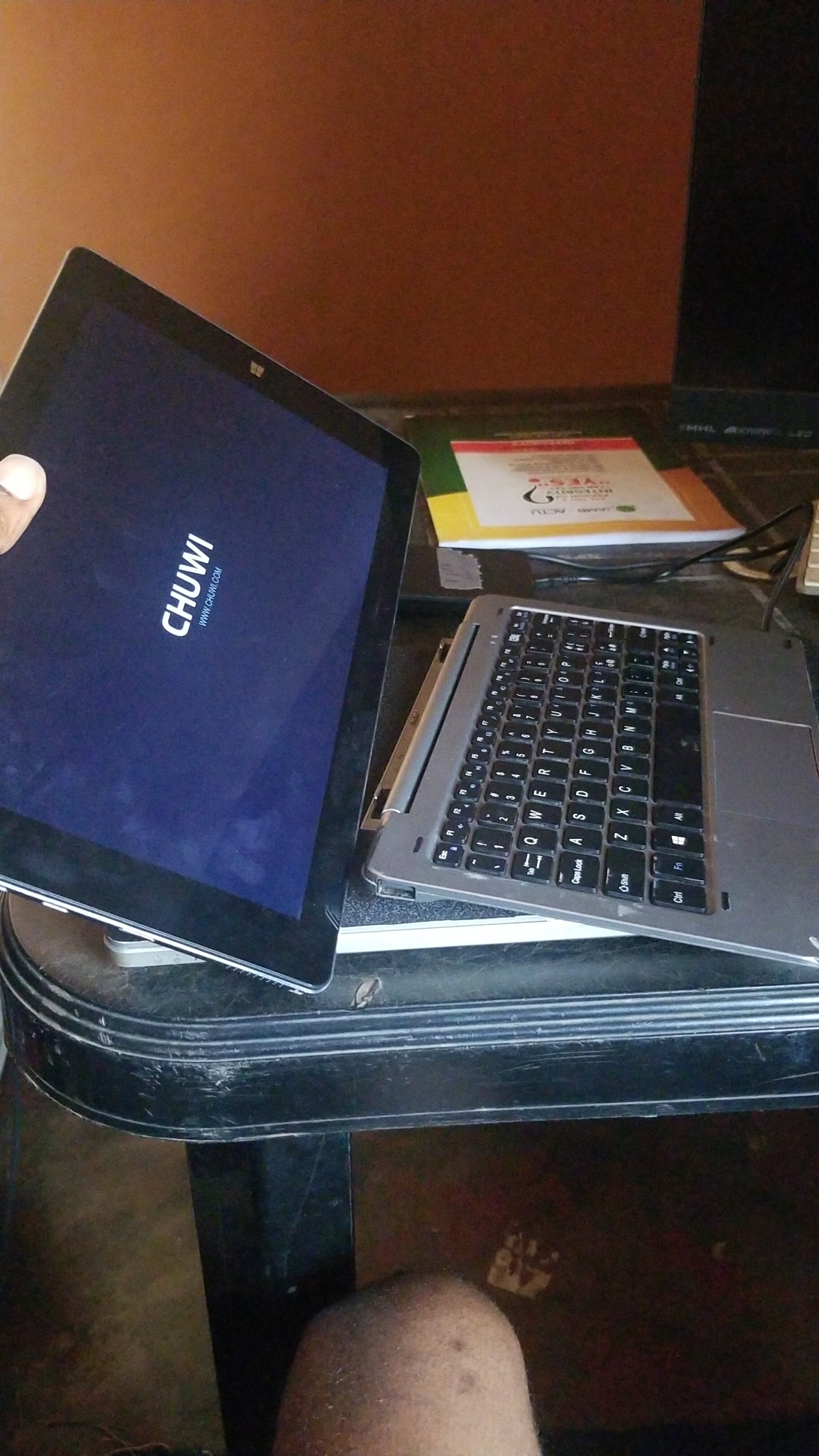

Beautiful Evening Admin, my chuwi Hi10X type cw1529 stuck on screen and refuse to boot to window after I did some settings on BIOS, it show CHUWI under it it show https://www.chuwi.com/, please how can I fix it

Good evening . The Hi10x refuse to enter BIOS setup thats the problem once it turn on it stay showing CHUWI on screen stuck, once u press the power button it goes off

i have chuwi Hi10x cw1529 window10. i did some settings on the bios now it refuse to bootup, it only show CHUWI under it https://www.chuwi.com/
, keyboard no longer work and USB port
