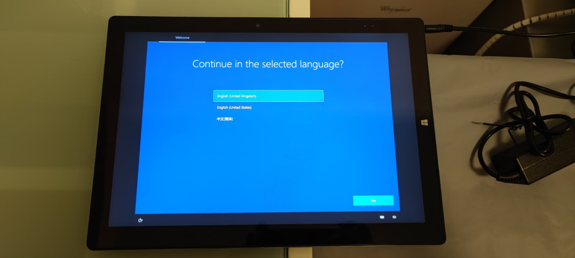

Connect the tablet to the power adapter, plug in power.
And thankfully the Ubook Pro started to power up :
The screen now no longer pops up at the top near the volume screen (which was how i was alerted to the problem - see first post) :
Tried the touchscreen and it seems normal.
I haven’t tried all the functions (wifi, bluetooth, volume, front and back camera) but for now, i’m just glad that it powers up.
