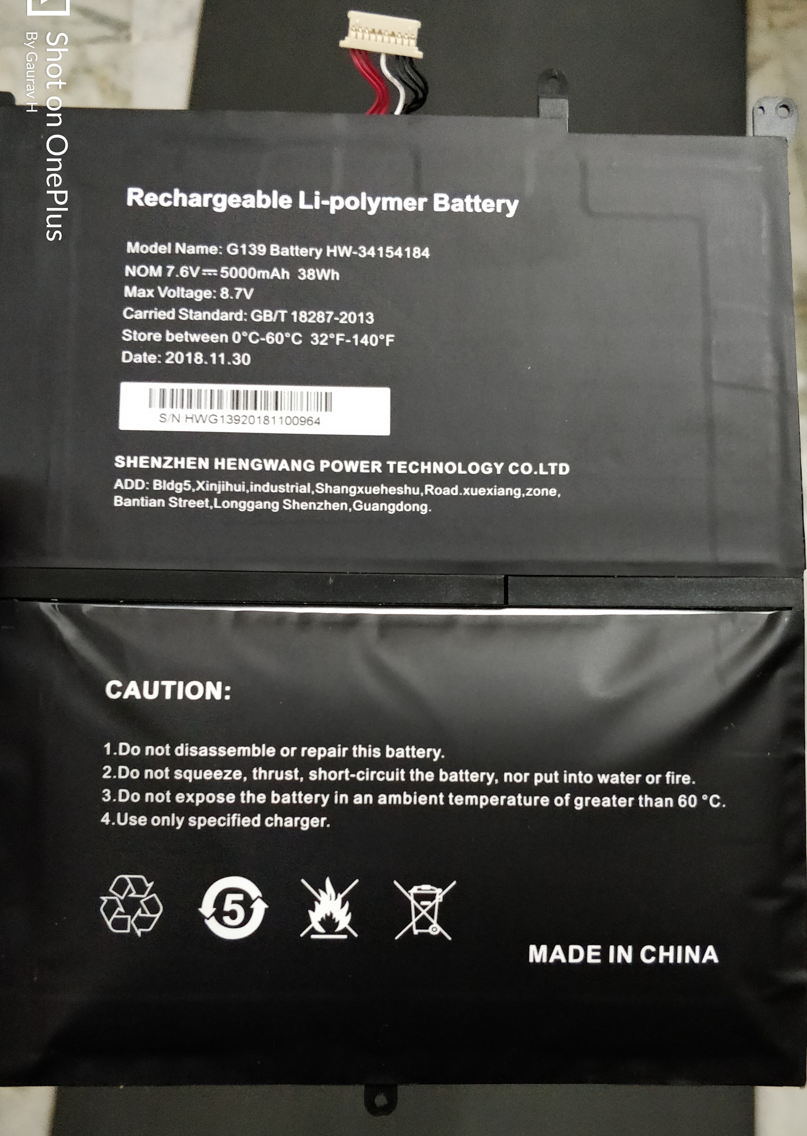

The battery on my laptop has swollen and become dangerous. Do you know anybody else’s email who can provide the support?
I do not understand why they are so hesitant to provide proper support for faulty hardware. If they want achieve a good brand name and image, this should be at the top of their priorities.
Please write to service@chuwi.com again and remove that battery first as it may destroy the laptop case. The AeroBook will work connected to the current with its charger

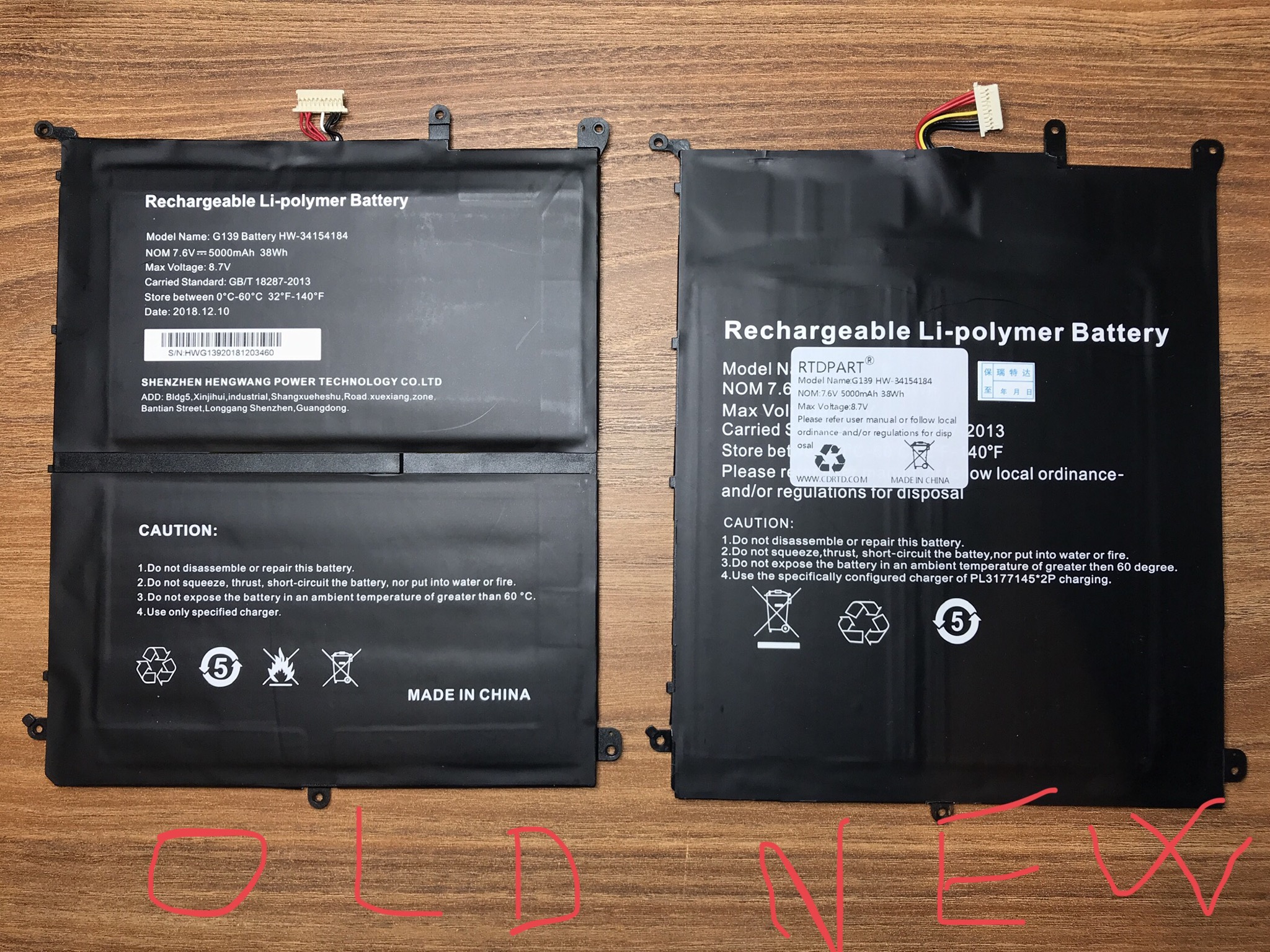

I did buy a new battery from Aliexpress and I use it for a two weeks and I don’t have any problems with it. It charges to 100% and discharges to 0% without unexpected shutdowns, it’s like a original and it lasts approximately 5 hours.
Here is the link: https://a.aliexpress.com/_mtVzjtL
